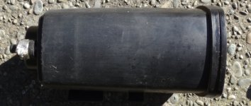

Managed to find the old one so this is what it looks like after its been removed, you'll see how I ended up just cutting the pipes off as those clips are really difficult.

Ok so lets discuss what the canister is there for.
Gas expands with heat, particularly the gas vapors. If your gas tank was completely sealed then there would be no room for this expansion which in extreme cases could fracture the petrol tank.
So the old way of solving this was to just allow the tank to vent these gas vapors. E.g. old gap caps on motorbikes would have a little hole in the top with a one way valve to let the gas out. However not everyone was happy about letting these gases into the atmosphere so manufacturers started using canisters instead.
What happens on the Spyder is there is a breather pipe from the petrol tank for these gases to escape. This goes into the canister which has various filters that are supposed to trap the nasty stuff before the harmless part is allowed out into the atmosphere (via a second pipe). There's also a third pipe that connects and allows the canister to be monitored - if it picks up there's too much gas in this canister then it assumes something is wrong and puts the Spyder into limp home mode.
The problem with the Spyder design is sometimes liquid gas can get into the canister (e.g. normally when you 'brim' the tank). Once this happens you tend to keep getting the strong gas smell, particularly when you've been out for a ride on the Spyder. It can take a long time to properly dry out again and in some cases the Canister has to be replaced. It can also trigger the limp home mode sensor (see above).
So the idea is to remove the canister, block off the sensor pipe so the sensor is happy and re-route the tank breather pipe so it just goes straight to the open air and can vent properly.
So in my first picture if you look pipe (1) that's the sensor you also took a picture of. You just need to block the short pipe off that originally went from the canister to that so the sensor is 'happy' and thinks the canister is still there.
Again in the first picture the second thing you need to do is extend the breather pipe from the gas tank (2) so it's completely clear of the engine area. Obviously you don't want the gases from the gas tank (or and gas itself) from going near a hot engine. You could just extend this pipe somewhere but the reason we put a fuel filter in is to just stop dust (or insects) from making there way up the pipe and back into the petrol tank.
