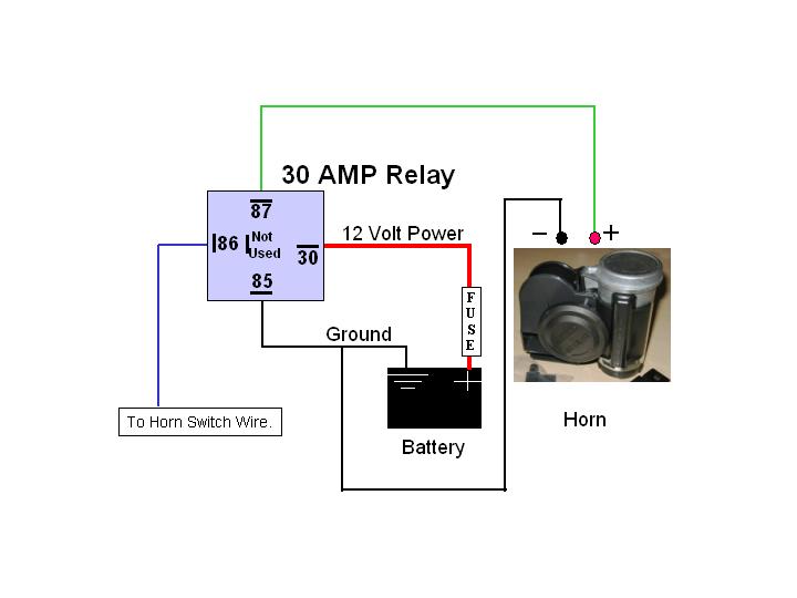

    I made my own harness and tapped the horn wire for signal. It works great and wakes up the cagers!
    I ride in any weather except ice, year round, and it has been perfect.
    This is the simple horn relay diagram, easy to do.

    The wiring diagram that has been posted on here for stebel/wolo horns shows hooking up to the battery for power to the horn thru the relay. Has anyone used power from some other place for the horn? Thanks.
    AKA Jud Smales, Four Year Spyder Ryder!
    "Quando Omni Flunkus, Moritati"
    The Critter 2016 RT-S
    Cat Bypass from Lamonster
    BajaRon Sway Bar
    Hella dual horns with relay
    BRP Hitch with trailer module
    Foam Grips
    Adjustable Air Deflectors
    Driver & Passenger Gel Pads in Seat
    Shorty antenna
    Ultraguard half cover
    Gremlin bell from my son
    Break Stripe Kit from Wrap My Spyder
    2016 RT-S , stock not yet Pearl White
    Mar 2015
    forrest above Reno, Nv
    3,632
    Thumbs up Relay/battery
    I used a heavy duty relay ( 30 amps) and heavy gauge wire throughout and direct to battery positive. Soldered connections are best ( yes I solder the ring connectors) Striebl is LOUD.
