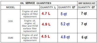

    BRP cares posted awhile back ...that the amounts stated in the manual was in-correct and people were over-filling at OIL changes ...............However the readings on the DIPSTICK are accurate and you should use them for checking the level of OIL in the system......What Bob D. posted above is the correct FILL amount ....Mike

    See the second and third bullets from BRPcare at this link:
    http://www.spyderlovers.com/forums/s...0-Oil-Level-on. The last oil change I did the level at five even quarts was at the add mark once I'd warmed the engine to the point where the radiator fans cycled twice. I subsequently added 10 oz addditional and now the level is a bit shy of the bottom of the full mark when at operating temperature. My old brain just wasn't satisfied running around with the oil level at the add mark.

    I simply put in 5 qts, with or without new filter, and it measures just over the top knob on the stick.

    I emailed BRP about a month ago was told that the manual was correct for SE6-- 5.6 quarts.
    The third bullet "...A new dipstick is not necessary since the oil level in the oil tank doesn’t change, only the method of adding the initial amount before final level verification. In other words, it's easier to add more oil if you underfill than to remove excess oil if you overfill." The new fill amounts give you a good starting point. I just did my RT SM6, put in the stated 4-3/4qts and full hot (10-mile ride plus idle) it got me up to the "add" mark. It took another 1/4 qt to get me to a little under the Max mark which is where I like to be. Pretty much the same experience you just reported for your SE.

    Quote Originally Posted by txhood View Post
    This certainly adds to the confusion. It's no wonder that dealers are confused.

    Quote Originally Posted by MikeT View Post
    That matches up with NOTHING...

    Unfortunately it does match up with something, Bob. It matches up with the original instructions for 2014 oil changes found in the owner's manual. The 2014 manual specifies adding 5.6 qts for an SE with filter change and 5.9 qts when the HCM filter is included. That manual is out-of-date and was superseded by the numbers you show above. I can't believe that the person at BRP who responded to the question was not aware of that revision. Now if you really want to get confused, look at the 2015 operator's manual. It shows the table you posted above in the oil change procedures section (page 125) and is up-to-date. However, if you go to the Technical Specifications section (page 165), it still shows the original higher numbers as the "engine oil capacity". Either BRP forgot to update the Technical Specifications OR they are saying these Tech Spec numbers correctly represent the ultimate capacity of the system. I'd like to think the latter is correct. The higher, original 2014 numbers and the 2015 Tech Spec numbers are the ultimate "engine oil capacity" numbers. But the procedure for changing oil has been revised to reflect that you do not get every last drop of oil out of the engine when you drain it. In order to avoid overfilling, start on the low side with the new numbers which are labeled in your table as "oil service quantities", then check the oil level when fully hot and bring it up as needed. As I said earlier, the new numbers are a starting point and you go from there. That's what Steve from BRP stated in his info and third bullet quoted earlier in this thread. That sounds like a good procedure to me.
    To give the BRP rep the benefit of the doubt, perhaps he quickly looked at the Tech Spec numbers and wrote his reply, not realizing or taking the time to find the different, lower quantities featured in the oil change procedure section. Or he looked at a 2014 manual for a 2014 question. Either way, I think he misled the person who asked the question and should have been aware of the new oil change procedure.
    Perfectly clear??

    Quote Originally Posted by gypsy_100 View Post
    Perfectly clear??
    ..." bingo "...I was going to post pretty much the same conclusion as you so eloquently stated .......Mike

    So I just changed the oil in my wife's 2014 SE6, using the CanAm oil change kit we bought from our dealer. I put in the new filter (hope I got all those o-rings in the right place), the BIG jug o' oil, and the two quarts. I assume that was about 6 quarts total. Oil level comes up to the top mark on the dipstick.
    Please tell me--did I put in:
    __Too much oil, and now I'm screwed. Have to figure out how to reduce the qty (by sucking some out??)
    __Too little oil (probably not the case)
    __Just the right amount, because the dealer told me that the kit had everything I needed,
    __Don't worry about it. Just ride the darn thing!
    Please help by checking the correct box.

    Quote Originally Posted by windancer View Post
    --Goldilocks
    If you put more than 5.2 qts in, then it was too much. There are suction devices on the market with small tubes that will go down in the fill hole to pull some oil out. Should be able to find something at auto stores, possibly Walmart. Heres what I use: http://www.amazon.com/ABN-Multi-Use-...e+Suction+Pump
    I never put in but 5 qts and leave it at that.
