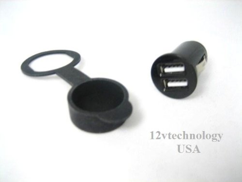

    This is what I use to give me 2 x USB Power to my Spyder RT 2015 SE6 Model
    CARCHETŪ Car 3.1A Dual USB Socket Charger Power Adapter Blue LED pour Phone PDA Tablet PC
    I have the base model so had spaces in the switch cluster below the handlebars
    I added a switch next to it so it can be switched on and off when needed - It's on constant power so it can be used anytime
    Very useful for powering my Sena SM10 Headset whilst riding
    Attached Images Attached Images

    Very clean looking install. How did you wire it in? That socket is available on Amazon and I have a couple of open spaces as well.
    Trb-- (Roger)
    2014 Cognac STL:Ultimate Seat, Nelson Rigg Tail Pack, Nelson Rigg RS/ST Half Cover, TL fender lights, Squared Away Laser Alignment, BajaRon sway bar and links, Akropovic Sport Silencer
    2022 White Pearl F3T
    I Fitted an extra fuse box Rowe PDM60
    http://www.rowe-electronics.com/modules
    This allows up to 6 Circuits - I just use one of the Circuits to give power up to the switch cluster and a bridge to give + power from the
    On/Off switch to the CARCHETŪ Car 3.1A Dual USB Socket Charger Power Adapter, therefore the switch once switched on passes power allowing
    the USP to become live
    See also my post
    http://www.spyderlovers.com/forums/s...Switch-Cluster
