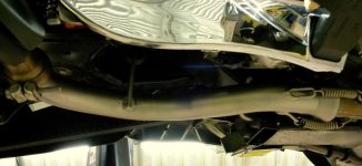

    Finished the cat bypass today and handbrake.
    Was able to bend the bypass from one piece of 2”,sure makes a big difference
    in and sound and performance.
    Handbrake works well from a design I used once before, not really wild about
    the master cylinder but hard to find a 22 mm or larger bore brake master cylinder.
    Nexus

    Do have any plans on making some to sell? I'd be interested.
    How is the sound? Slightly louder, much louder?
    Secondly, how the heck did you get to the spring on top to remove/replace? If they are anything like the ones Rotax use
    on their ultralight motors, they are one strong spring. I used to
    use loktight pliers to get a grip on them, but obviously that won't work on that top spring due to limited space.

    As far as sound its deeper( lower tone) I really don't know what to compare it to
    but not loud. I had dual exhaust and Supertrapp mufflers on the last two Spyders
    but I promise the wife I would not do that to this one as she could not stand the
    noise.
    As far as selling the bypass I'm not in that business Lamont make some good quality
    Spyder's accessories and this is his livelihood, and this is just a hobby for me. I waiting
    on his new highway pegs now.
    As far as the Springs you're absolutely right on that one the hardest part of this whole bypass
    was that one spring that hard to get too. I have a Band-Aid on my right thumb right now
    because of it. I did use a long needle nose Loktight pliers one advantage I did have I was
    standing up doing it.
    Nexus

    Thanks for feefback on sound and spring; I figured that top spring would be a bear. Maybe someone at Spyderfest will be selling and installing them.

    Guys, use a cotter pin extractor for those springs. Makes the work much easier.

    Just an Fyi ISCI uses a Harley Davidson hand brake master cylinder for their kit much better looking also.
    Very Active Member oldgoat's Avatar
    DDO, Montreal Island
    1,258
    Your handbrake is identical to mine.
    Same master cylinder & same red slave cylinder.
    Where did you get the slave cylinder from? What model is it & who made it?
    I bought mine from someone on this board, so don't know its history.

    This is my design from six years ago and the third prototype that really worked.
    Everything is still available total cost of materials around $200.
    I know others make handbrake kits for the Spyder this is my homegrown version
    without the machine shop.
    Nexus

    Here is an example of the sound without the cat.
    I wouldn't say it's a good example but it will give you an idea
    of what it sounds like with the stock muffler.
    Nexus

    Always hard to tell from a video.
    May also sound different w load on it like going down the road.
    Sounds like there is a little bit of a raspy tone to it.
