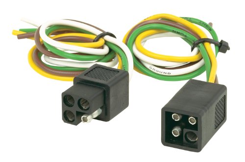

    We just had the Factory hitch installed on our 2013 RT-S it came with a SQUARE 4 plug and my trailer has a FLAT 4 , where can I find a SQUARE 4 adapter ?

    There is no adapter that I know of. There are several ways to address the problem, however.
    1. Purchase a universal adapter from a trailer shop. This is a cable with four loose wires tied together in the middle. You can switch the wires around to fit any 4-wire connector shape...or even switch the light functions.
    2. Purchase a square-4 pigtail and replace the flat-4 or splice it into your trailer so it has both.
    3. Purchase a flat-4 pigtail and replace the Square-4 on the Spyder or splice it in and have both. I do not recommend this alternative because empty connectors on the live side can corrode or short out, and replacing the Spyder side with a flat-4 makes the harness an oddball as far as Spyders are concerned.
    4. Purchase both flat-4 and square-4 pigtails and make your own adapter.

    Add a 5th one. Buy a 12" 4 flat extension, Hopkins #48145, and modify the one end as Magdave shows. You should be able to find one most anywhere that carries trailer wiring stuff.

    Cheapest way to solve the problem I have found. BRP wants $65 for a $5 plug

    I had the same issue. I cut the flat 4 off my trailer and replaced it with the hopkins square 4.
    http://www.amazon.com/Hopkins-111479...re+4+connector Simple as it gets.

    I have those saved on amazon but you still have to splice. The solution I posted above all you have to do is cut the plug in 1/2 and glue them together. Splicing unless soldered and shrink wrapped tends to oxidize and ends up being a weak link. Still a viable way to do it though. Always remember to use Di Electric grease too.

    I recommend that if you splice you use Posi-taps and waterproof the spliced end with heat shrink tubing. If you replace the existing connector use waterproof butt splices.

    Simply change the pigtail on the trailer. BRP has it in the catalog. I am assuming you have the RT-622 BRP trailer.

    Thanks for all the input guys , I just bought a tent trailer and wanted a clean looking harness , I have seen far to many muddle jobs out there and knew someone would have a great solution .
