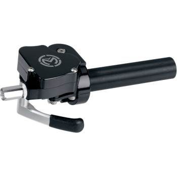

    Google, Thumb throttle you might have some luck. Also try Moose racing.Sorry I couldn't get it to activate the web cite to just punch on but the article looks like this is what you are looking far.The page is Dual gasser throttles $ 149.95 also have other kinds good luck. And THANK YOU FOR YOUR SERVICE !!!!!
    http://asset.lemansnet.com/edge/0/6/...50&t=image/jpg
    Maybe the first thing that you'll need to find out; how much does the cable need to be pulled through it's full travel?
    Once you know that; it should be easy to ding one that matches up!
