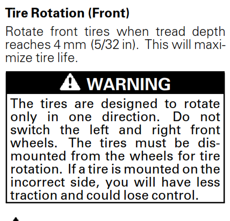

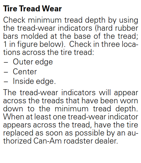

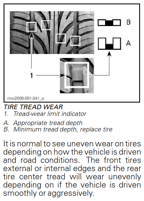

    Default From the 2012 Spyder Manual.....
    Quote Originally Posted by SPYD1 View Post
    Make sure that the rotation on the tires is correct after they rotated them. They are directional and have arrows on them. Other than that if they are worn badly rotating them might make it worse. There are three sets of wear bars on the tires. This is explained in the manual, use the manual as a reference.
