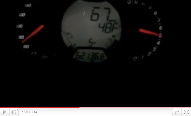

100,000 KM (62136.8 miles) fix for the GS/RS
They have a fix for your odometer now that will allow you to go over 100,000 KM (62136.8 miles) without resetting.
Here's the catch, you have to get the software update BEFORE it turns over.
Have your dealer make sure he has the latest version of BUDS (3.0.5) and then have them go to the toolbar and go to modular>cluster and then they can download the update.

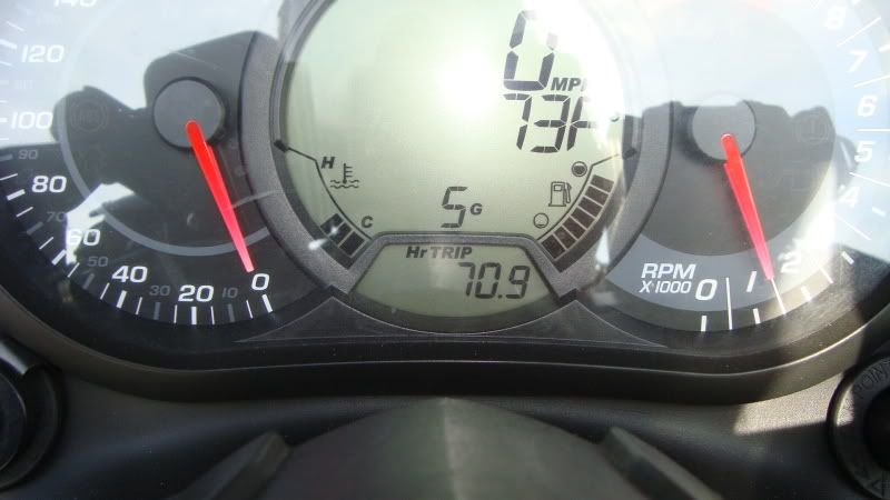

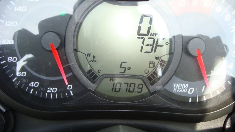

You will lose the 10th of a mile in the odometer but it will be retained in the trip meter.
