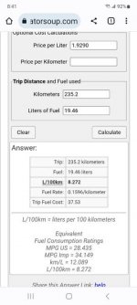

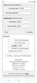

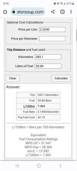

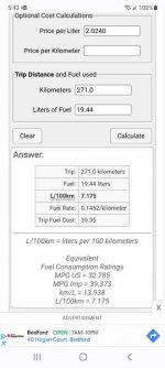

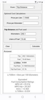

    Most of the time I refuel when the 3 dash lines appear. I usually top-up the tank every time I refuel. It usually takes between 19.5 to 20.5 liters of fuel to fill the tank.
    The tank capacity is 26.5 liters (7 US gal).
    This means that I normally have about 6 to 7 liters (1.6 to 1.8 US gal) of fuel left in the tank when the 3 dashes and low fuel light appear.
    So now I know how much fuel I have left when the low fuel light appear.
    In order to keep the fuel pump cool, I would not want to go too far below the Low Fuel light.
    Screenshot_20230917_203556_Chrome[1].jpg Screenshot_20230901_174305_Chrome[1].jpg Screenshot_20230814_224338_Chrome.jpg Screenshot_20230730_204124_Chrome.jpg Screenshot_20230715_142316_Chrome.jpg
