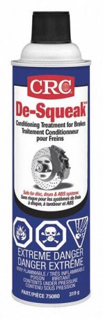

The backing plate gel is usually a better way to go. But best to do during brake pad changes while you're already disassembled.
But for easy, you can't beat this. Results vary. But this works most of the time. CRC, Permatex and others make a similar product.
I agree with Ron. Also, CRC makes excellent products.
