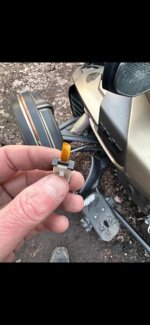

    BamaJohn, I think I discovered where you went wrong. The pic shows you putting the BB on the turn signal side of the switch. This pad is double sided. One side does the turn signals and the other does the shifting. You need to put the BB on the shifter side of the switch. Careful when you take the shift mechanism apart to change out the ball for the BB as there is a spring loaded detent ball that will come flying out. Fixed one today that way. I hope it holds up. Will try and do a better description later.
    Thanks EdMat. My photos might not be adequate, but I did put the BB on the shift side of the switch pad, but it stuck in the housing....wish I had you here back when this began

    "EdMat" might have more info for you, but here's my update: After the original posting I wound up having to replace the whole switch assembly with new. The oem ball bearings in the switch assembly are smaller than a BB, so the BB would only work one side then sticking in place, disabling the other side of the assembly to work (I made it shift but lost turn signals, for example). Sorry I don't have better news.....

    Sadly the BB worked for a while, like every other thing I have tried. We are at the point now of replacing the whole left hand assembly. At the last failure what I found was, pressing on the switch membrane would no longer cause any function at all. It makes me think that one of the contacts is disintegrating. I won't know for sure until the assembly is replaced and i can tear the membrane apart.
    My thought now is that everything I have done to this point has been an illusion and the only thing that made a difference was every time we did something we caused a slight movement during reassembly allowing non deteriorated parts of the contacts to make contact.
    Not sure when he is going to spend the bucks for a new assembly.
    So the BB on the paddle side only worked for a while? I'm thinking about a small metal cap over the stud on the membrane. About 0.02 inches in thickness. If you ever saw a primer for a shell or a percussion cap for muzzleloader, think that type of cap. Pics show placement. As soon as it stops the torrential rain here in VA, I'll get outside to try something. Any thoughts on this idea? I concur with the lead bb being too soft and that it may cause other issues if it flakes inside the switch assembly. It needs to be a hard metal.
