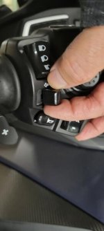

    I have just installed both the button and the shifter pad. It was a piece of cake.
    I just slowly pulled-off the button with the assistance of a small flat screwdriver below the button.
    You will notice that the button's pin receptacle is at the bottom of the button. Just push the new button in place with the pin receptacle at the bottom and it will fit perfectly.
    In order to ensure that the shifter pad adhesive hold correctly to the shifter button, I used an alcohol swab to clean the shifter button first.
    Let the button dry or wipe dry. Then just peel the adhesive off the back of the pad and apply carefully on the shifter button.
    Voila!
    I have not taken my Spyder out yet due to the snow, but did try the new flasher button and I like it a lot.
    Thank you very much to both TC and Dave for the excellent mod!
