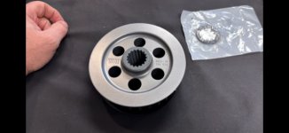

    Default New sprocket
    Hey Greg, I saw this video myself this morning. Was going to post it but you beat me to it. Lol
    He did say this was the final sprocket needed for the recall. In the video you can see it is grey
    not white or black. I will try to post a screenshot I took from the video.

    Thats cool! I haven’t seen the new sprocket. Looks like a stamped aluminum flange, separate gear pulled together with a pressed inner sprocket. Good idea, Therefore, if the inner sprocket was to fail again, it could be pressed out and new one inserted. No need for an entire new sprocket. Very nice design unless the pressed inner part fails which could be fixed very quickly with a pin through the inner press and shaft. The belt would simply run right over it with no problem. I like that design.
    Edited: after watching the video it looks solid instead of pressed. Will have to see in person I guess. Picture is deceiving.

    Based on the video, the fix will be bonding the pulleys to the shaft with Loctite.

    Quote Originally Posted by Partzman23 View Post
    See the part # on the new sprocket that is silver in color (705503244) dated 7/22, that is the same # that I have on a brand new White sprocket dated 10/20

    Quote Originally Posted by T.P. View Post
    T.P.
    AND, that part number does not show up on the BRP parts fiche. Just the old one. So, which is right?

    So the washer is a sort of sacrificial item is it if the loctite fails

    Quote Originally Posted by Cobwebs View Post
    My take on this is that the washer is there to protect the seal on the splined shaft when you have to heat the pulley to loosen the loctite to remove the pulley in the future when this fix also fails. I believe a shaft drive would eliminate the problem. .......Bill

    Quote Originally Posted by Knizar View Post
    Perhaps also to provide more space on the outer flange to keep the belt from rubbing...depending on how it is adjusted.
