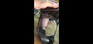

    Quote Originally Posted by BertRemington View Post
    Would you like me to measure the thickness of the plastic? I've removed the speakers and radio to make room for another project (if anyone wants them let me know) and I'll measure it for you.
    Looks scary thin to the me.
    Got that from https://youtu.be/IZ8sNuJvPd0
