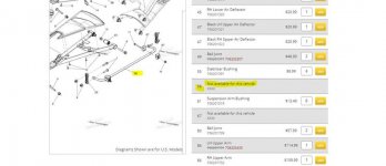

    The above picture came from Can-Am Parts House (graciously provided by RayBJ in a different thread). Why I ask the question since Can-Am Parts House says they are "Not available for this vehicle"
    See>> https://www.canampartshouse.com/oemp...spension-front

    Go back to the parts. P/N 44 is the sway bar. There are 2 different pictures. There could be a error. The 2014 RTS shows the same p/n as the 2015 RT.

    Looks like the labels are wrong. #44 and #58 are each sway bars not bushings.

    All the Spyders have sway bars as far as I know. I've never heard anything to indicate otherwise.
    Look underneath yours to verify.

    Just look for the heim links.

    Thanks didn't think it was right. Better asked than not.

    All Spyders/Rykers have a sway bar from the factory. If you look at that parts fische posted, you'll see the bushings and shock units in that segment are also not available. Which simply means those parts have been superseded. It would be nice if that information was also provided.
    BRP changes suppliers and this generates a new part number. Even if the part itself is identical. Which is many times the case.
    The sway bar for the Spyder has not changed since it was redesigned in 2013. The bushings, however, are not as good as they used to be. We have been finding ovaled out bushings on the 2020+ machines. Some with very low miles on them. Injection molded bushings don't hold up well as a rule. But the earlier ones seemed to do fairly well. Not sure what BRP changed. But they need to go back to what they were doing before..

    All Spyders have a sway bar.
    Many have found improved handling by upgrading to a more heavy-duty bar, one of the best is supplied by BajaRon.
    Check out the links that connect the bar to the body. If they are plastic, chances are you have the OEM bar.
    If they are metal. you most likely have an upgraded sway bar.
