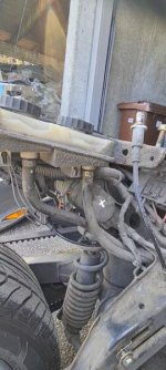

    Also, here is a pic of my compressor location! (White x)
