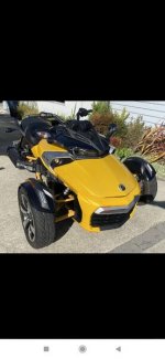

    Default My new baby - which gas? 87, or Is 91 octane better?
    Just got it this weekend and put my first petrol in it today. After I got home I read it was better to put 91 octane in it? is that right? I thought higher was better?
