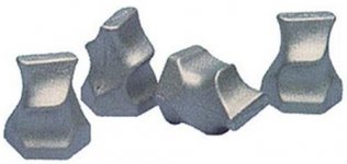

    I ride 2-up a lot. I place Elka stage 4 in the rear so I would not bottom out. Much of the time Im ok, but still have been bottoming out here and there. I adjusted preload as much as I could and I REALLY REALLY REALLY do not want to take off the suspension to replace or add any spacers. I see that there are spacers widely available for cars but I do not see anything for motorcycle suspension. Any suggestions on where one might find something that i can just slip between the coils to add some stiffness so the fender does not meet my top case anymore?

    I do not know of a spacer for the Elka. But I highly recommend NOT using the turn knuckles. They are easy to install and will work fine at first. But they put all the load on a small area of the spring. The spring tends to flex on each side of the knuckle which fatigues the steel. After awhile, you will need to add more knuckles or replace the spring.

    Yeah I saw those, but it seemed to me that the spring would bend around those knuckles over time. I saw the round plastic ones that wrap around the coil for the car but I cannot find anything that is small enough for the elka shock - probably around the same size is Fox shocks or the OEM one that came with the Ryker Rally
