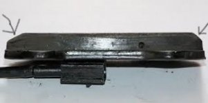

    If you want to decrease the noise of the brakes a lot, file the corners of the brake pads like the picture so that the brake dust comes out.
    FlyBoy2121
    All good Tips. The beveled pads are needed to get a noiseless operation. Most of the better brands of pads have this beveled edge. I only install beveled pads.
    Also be sure to use 'special pad grease'. Most auto parts store should have it.
    My Tip: Install beveled pads. ......

    There are several things you can do to reduce squealing. Which, as mentioned, is a high frequency vibration. Pictures are meant to be representative of the advised action only. They are not Spyder or Ryker pad sets.
    Bevel the leading edge with a file. I don't recommend filing the trailing edge. You don't back up that much and filing both leading and trailing edges will reduce pad contact more than necessary. Pads come with both edges beveled because they don't know which way you are going to install them and they want to be sure the leading edge is tapered. If you're doing the install yourself. You can end up with a better job by just doing the leading edge.
    Cut 1 or 2 lines in the pads. This removes very little material. This squeegees the rotor helping it to stay free of brake dust. Another reason for squealing. It will also help to shed water. But this is not really a problem with disk brakes. Personally, I prefer 2 diagonal lines cut. But I cannot say that this is any better than the other approaches. I use a hack saw. Do not cut all the way through the pad. Leave a little meat at the bottom of the pad.
    Coat the back of the pad with a thick layer of Anti-Squeal gel. This gel absorbs vibration. Vibration builds on itself. If you can prevent it in the first place, it should solve your squeal issues. You want to put it on fairly thick and let it dry for a bit. Giving it time to set up before installiation.
    Clean and then apply Anti-Seize on sliding parts. This will help the pads to move freely and wear evenly. Use a very thin layer. This is not a product where a little is good and more is better. This is a case of a little is good and more is not good.
    Once installed. I recommend 'Bedding In' your new pad set. This requires that you go from 60 mph to 20 mph as quickly as possible. This needs to be done at least 3 times in quick succession. Do not come to a complete stop. You should start smelling hot brakes. This means that the brakes are getting hot enough to cure the resin which is used to bind the friction material. This curing process prepares the brakes and will not only make them stop better. But will also reduce squealing. This can also be tried as a cure for squealing brakes.
    Be sure to do this on a clean and dry stretch of roadway, free of traffic and long enough to accomplish the task without having to stop.
    Once you've completed these 3 consecutive hard stops. Ride at least 5 minutes with little or no braking to let the brake components cool evenly. If you stop with hot brakes. The very hot pads are clamping on a small portion of a very hot rotor. Which can cause warpage. Riding for 5 minutes with little or no breaking will prevent this.
