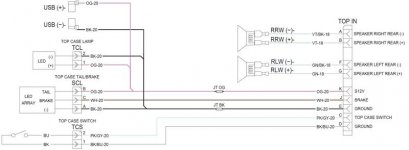

    This might help...

    Quote Originally Posted by Jetfixer View Post
    This might help...
    Hmmmmmm. So since BOTH the USB and the trunk light aren’t working, it looks like a break or disconnect where either the power or earth cable joins the trunk brake cluster cable? I am NOT an auto electrician……just my thoughts.

    Since both the ground and +12v are common to the USB, trunk Light and tail/brake lights and the tail/brake lights are working then the problem would seem to be in the harness. Is there a place to check for voltage at the trunk light? If not then I think you'll have to remove that harness and see if it can be repaired other wise a new harness is probably the fix. Its likely a broken wire, ground or +12v inside the wire insulation, tough to find. Wiggling that part of the harness to see if you can intermittently get the trunk light to work would confirm.

    Looking at the wiring diagram from Jetfixer I think the two pins with no reading are the leads that go to the top case switch. That is undoubtedly a low voltage signal connection, and may even be a digital signal that is intermittent. You need to check the voltage at the top case light connector and the USB connector. I suspect the wires are reversed on each one, hence neither one will work.

    If you want to fix it you will have to start at the usb plug and work backwards till you find the break, be it either a ground or power issue. The orange wire coming out of the plug supplies power to the usb plug, light and brake lights. If one works without the other then there is a problem. These wires are so small that they are very easy to break.
    My guess is that where the wire is spliced the 1st time is where the problem is.
    Thanks to Jetfixer for posting the diagram while I was sick.
    You may very well be on to something here. Since almost every 2020 RT came from the factory with the gps harness wires reversed, it's very possible that the 12+ and GRD are reversed in the connector...
