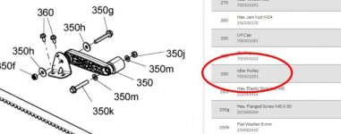

    For info on setting your belt tension and alignment. I'm guilty as charged for calling it a belt tensioner and not a vibration damper but technically it's called an IDLER.
