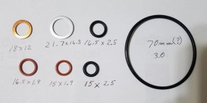

    Quote Originally Posted by Cobwebs View Post
    I need to stock up from ebay does anyone have this information at hand?
    Wasn't at hand, but I got it! This should help, I think! Ever tried measuring the diameter of a flexible ring? My numbers should be close, but they are a bit squishy! (pun intended!)
    The O-ring numbers are OD x Thickness. The washer numbers are OD x ID. All are mm.
    Come on this is a family show Idaho
    Your the man that's perfect thanks !!!
