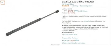

    This one works as a direct replacement. it's the 40 PSI version
