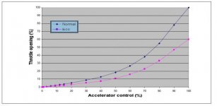

    A two second push on the Mode/ECO button turns the ECO mode on or off and the picture shows what the ECO mode does to the accelerator percentage.
    You would think that a 40% smaller throttle opening at 100% throttle control would be noticed easily. Guess it's time to drag out the stop watch and do some testing. Maybe I'm just getting too old to notice any more.

    Turning on eco definitely changes the throttle position. I can feel the speed drop and watch the tach lower. Turn it back off, and it speeds back up. I can also hear a lot more air box noise. I have been wondering if it changes the automatic downshifts, but can’t tell.

    ... and the picture shows what the ECO mode does to the accelerator percentage.
    What was your source for this graph?

    I have a Green service manual for my '14 and it came from a section of it entitled "Rotax 1330 ACE Engine Dealer Presentation." IMO, the ECO mode is an unnecessary nuisance; however, one could make a pretty convincing case that it is beneficial to those who have never used a hand throttle controlled vehicle.
