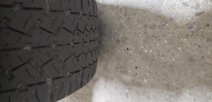

    Rear tire is about at 5/32nds. So, as I said, it probably has a couple 1,000 miles yet to go. See photo.
    I do ride fairly aggressively but I do not do burn outs. (until just recently as I know I'm going to have to replace this tire ).
    Front tires look fantastic. I would say that I probly have another 10,000 miles or more on them.

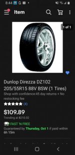

    I decided to go with the Dunlop Direzza DZ102. Ordered it last night. See picture attached.

    Wow, the roads in Indiana must not be anywhere near as abrasive as the chip seal abominations we have here in Texas. At 7,000 miles I am down to 6/32nds and I do not expect to make 10,000 miles. I will be interested to hear how you like the Dunlop.

    Thanks, a lot of good info there. That Dunlop tire looks good, I saved that for future reference when needed. Not a lot of quality tire options out there as of yet.

    All of my wear bars are flush with the tread but I have 5/32nds of tread left. That's a bit frustrating that, according to the manual, I have to replace my tire with 5/32nds left.
    Dec 2013
    9,650
    Quote Originally Posted by RykerUSA View Post
    Are you sure you're looking at the 'Tread Wear Indicator' bars, and not at the 'Tread Block Stabilisation' bars?? Look to the sides of the tread - if you are running the OE Spec Kendas, there will be a little triangle embossed upon the edge of the tread pointing at the 'Tread Wear Indicator' bars.... if you can't find a triangle on each side of the tread pointing at those bars, you are NOT looking at the 'Tread Wear Indicators'!!
    The other bars are there to stabilise the tread blocks on either side of the deep tread grooves and to force any water/ice/slush that may get trapped in those grooves to 'break out' of the groove as the tire rotates and help clear the grooves for the next revolution.... and they will generally become flush with the rest of the tread surface about 2/32nds BEFORE the Tread Wear Indicator bars wear flush.... but the Tread Block Stabilisation bars WON'T have those little triangles pointing at them!

    You're exactly right. I was not looking at the tread wear indicator but the stabilizer blocks. Thanks so much..
