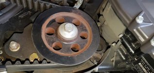

    I was doing an oil change and inspection. This is what I found, picture below. Called the dealer. Because it is still under extended warranty. They are really busy so next available appointment is October 14th. So I put it back together and will drive it until then. If it was not under warranty I would have just bought a new pulley, grease and replaced it.

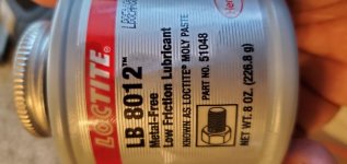

    have the dealer add loctite moly paste to the shaft splines before installing the new pulley. Its fretting and breaking down the pulley. The dealers should be pulling all these and getting ahead of the problem, but seem content to let one after the other fail and then address the problem. Took my dealer 6.5hrs to get my old pulley off. It didn't fail as I caught the dusting, but it was stuck. Best of luck in your fix..

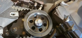

    I like the way you mark your washer and pulley for a reference!!!! good idea

    OMG, JUST GOT BIT BY THE 'RED RUST DUST' MONSTER......
    lucky i was on this website this AM... i went out to 'mark' my 'washer & bolt', and low & behold, RUST DUST....
    i bot my ride in Dec. 2019, it's a 2019 F3, and it only has 4438.4 miles on her, and now this.... it's absolute BS in my estimation that BRP has let this issue continue for the past 4 or 5 yrs...
    check out the pix....
    calling the dealer tomorrow... hopefully they'll have a sprocket on hand...
    Dan
    SPYD3R

    You caught it really early. They may only take it apart, clean and grease it. If I remember correctly the TSB says that the pulley is only replaced when there is wear on the pulley.
    HELP me out here.... the SPROCKET slips onto a SPLINE... what is the purpose for the LUBE, and how does it effect the assembly...???

    Not wanting to pay a high fee for the moly paste I'll never use up, would this product suffice for a spline lube? Just 4 ounces at $7.55
    https://www.amazon.com/Liqui-Moly-20...EGECPFCG2EWRH0
    Or this one?
    https://www.amazon.com/dp/B00BO8A6P6...NsaWNrPXRydWU=
    Or thus one?
    SoFlo
    4,361
    Or this one?
    Or thus one?
    Of those listed, go with the assembly lube
    Feb 2019
    Portland, Oregon
    2,735
    Quote Originally Posted by PMK View Post
    Thank you....muchly appreciated.

    The purpose of the lube is to reduce the chance of the metals fretting. I'm not sure how freely it installs. The constant pressure from the output shaft against the pulley will eventually wear down the pulley(softer metal). The moly paste is there to act as a protective barrier between the metals and reduce the chance of the pulley breaking down and creating the red dust.
