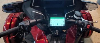

    I put the new Garmin Garmin Zumo XT with Lamonster Ram mount on his Handlebars mount.
    It pushed it up a little too tall for me so I took off the RAM mount off of his aluminum bracket
    and bolted directly the Zumo mount to it. Surprisingly the holes were the same and so are the
    threads. I use the same bolts that held on the Ram Mount to put on the Zumo mount.
    It sits low and flat but easy to see and out-of-the-way

    I put a Zumo XT on my 2020 RTL. Please see the photos and perhaps this will help you in your decision making.
    Rob

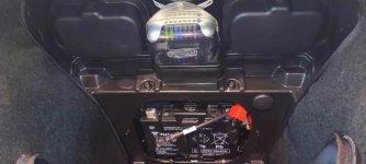

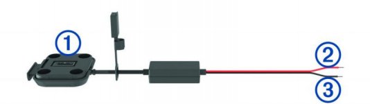

    This was the easiest GPS to hook up all it has the hotwire and negative.
    I put in a separate accessory fuse panel 14 circuit-7 hook to a solenoid for
    the key switch that turns on 80 amp relay for power.
    The other 7 have power on always with a 40 amp main fuse.
    All you really have to do is hook it to the battery it's fused already.
    Some people would rather have it hooked to the accessories when you key the switch.
    I have mine hot all the time. I have found once it is fully charged it has no draw on it.
    (The device must be mounted in a suitable and secure location on your motorcycle,
    based on available power sources and safe cable routing. No fuse is required
    https://www.youtube.com/watch?time_c...ature=emb_logo

    It is a pretty easy hookup and the only thing I would add here it that if you route the wiring really tucked away in behind the bodywork, try to make sure that you have easy access to the fuse just in case something happens and it blows. Mine ended up being accessible by just raising the frunk lid.

    Did you run your power cable directly to the battery, or did you use the switched accessory connection under the frunk ?
    2022 RT Sea To Sky
    Active Member triplethreat's Avatar
    Feb 2020
    "Murvil", TN
    166
    I used the switched accessory wires under the frunk. I figure that if I'm stopped somewhere and I need to use it without starting the Spyder, it's got battery power to run on. And BTW, those wires are hidden really well, I looked and looked and looked some more. Finally, I bit the bullet and pulled the battery and they were off to the "clutch" side of the battery. It helped that I had a Service Manual that I downloaded right after I got the Spyder and knew what color wires to look for.
