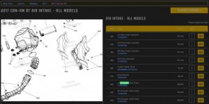

Found them
707800696
LH Acoustic Shell Foam
$25.99 USD
Available
400
707800338
RH Acoustic Shell Foam
$14.99 USD
Avai
450
707800697
$25.99 USD
Available
450
707800339
$15.49 USD

Just rechecked the parts list and it does show the missing panels that you are referring too. Part number posted #7

You present an interesting situation. Since you are merely doing parts research, using the BRP online parts catalog seems superior in quality to view.
As you noted, the 2017 does indicate foam. Not exactly certain I noticed what I would deem the large plastic acoustic panel. I did take look at the 2018 parts catalog. In that the foam is omitted, they still show what looks like an acoustic panel, but call it something else.
If you take a look at the 2019 it clearly shows the support.
As a hunch, after seeing your Spyder having the support braces, and no panels, I suspect, the parts book may be in error. Unless you believe at some point someone removed the acoustic panels and replaced them with braces.
