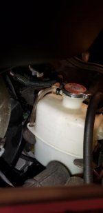

    Hi All! I am new to forums. I was unable to figure out how to post my own thread, but I have an issue that is similar to this one. Could help us all with some learning. I believe I have a breather tube issue. I took my bike out to work yesterday and went on a lunch break ride. When I went to leave for the day I noticed a large puddle of antifreeze underneath my bike. Got the bike home, took off all of the panels and noticed that half of my antifreeze tank was empty. It was halfway between full and fill. Got to looking around. Everything looked fine underneath except there was a container directly behind the antifreeze reservoir that was soaked. I felt all 3 tube connections that are connected to the reservoir. All dry except the breather tube. Directly underneath the breather tube was a puddle of antifreeze. That is my best guess of the problem. Any clues as to why it would all of a sudden decide to throw antifreeze everywhere? I attempted to load a photo. Again, still new to this so I am not completely sure how to navigate this yet. If it helps, I have a 2011 RSS 990 SE5. Thanks for any help! Antifreeze reservoir.jpgAntifreeze reservoir.jpg

    I'm thinking it could be the cap not sealing well. All my connections are dry and I don't see any cracks. I'll add the coolant and replace the cap. I'll also have the dealer look things over.

    Most of the caps on these machines have a second detent when installing the radiator cap. Not a smooth operation and tough to say the least so when installing the cap make sure it clicks into place twice. The first is to avoid the cap from poping off if checking engine hot and burning the persons hands etc the second is to seal the system for operation. Have seen many on the first only and system works but will leak...

    It's fairly easy to get the cap on wrong or not tight (last detent takes some effort as Chupaca says). The cap may well be your issue. Especially if someone has opened it recently.

    Do the reservoir caps on all of the models have a double lock in basically?
    Dec 2013
    9,650
    Yes they do, dmjessup. In fact, so do the caps on most motor vehicles! It's basically an 'industry wide' standard.

    Just shows you how much of a mechanic brain I have! I guess I will see if I can't get the cap tighter and see if this doesn't fix my problem. Thanks everyone!
