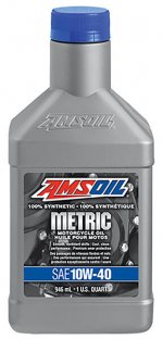

    Ron, what weight and exact AMSOIL do u use? Can u post a pic of the bottle. Thanx Rhino

    Amsoil MCF 10/40 is what we use and recommend. Some that run in triple digit temps go with the 20/50, which is not a bad idea. In my opinion, the 10/40 is a better viscosity than the 5/40 that BRP recommends. I've detailed why elsewhere so I won't bore everyone again with it. I also feel that a 'Blended' oil is more marketing than it is value.
    BRP recommends what they sell. And though they used to sell and recommend their 10/40, they don't have that viscosity anymore.
