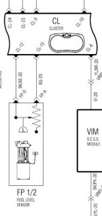

    According to the wiring diagram. The fuel level function has 2 wires from the gauge cluster to the fuel pump. No connectors or junctions in between. That narrows it down to the connector on the back of gauge cluster, connector on the fuel pump or defective fuel pump.
    If the fuel pump was defective ie. NOT pumping gas ….how could the engine run ????? ……………..Mike
    I am not sure how you got the idea that I said or meant the fuel pump was not pumping fuel. The fuel level mechanism is part of the fuel pump. So if it is broke. Replace the fuel pump.
