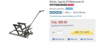

    What type of jack you got from Harbor Freight? I'm considering getting one. Can you post a picture? Thanks

    Quote Originally Posted by Bigmo View Post
    Item # 60536
    Min. height: 5½" enough clearance for my RT.
    https://www.harborfreight.com/1500-l...ift-60536.html
    My only complain about this is the speed of the drop. You have to be extremely careful when stepping on the release pedal as it will bring down your spyder way too fast.
    I work for PowerLift, we were one of the first ones to bring this exact same jack about 20 years a go for Costco and Advance and we had HD customers complaining about this issue. So we modified the release valve to where the jack would only come down if the load was heavy enough and even if you put your whole weight on the release pedal, the load would come down very slowly. Unfortunately Harbor Freight won the race and we discontinued it.
    I sold the last replacement jack about 3 weeks a go. One week later I ended up buying this one from HF. I should have saved a jack for myself.

    Thanks, i'm getting one today. One last question: I know that it takes a 36mm low profile socket for the filter. How about the two drain plugs? is it Torx, Allen and what size?
    Is that all I need, as far as tools? I'm ready to do my first oil change (last one I had dealer do it for $427.00) Rip off.....
