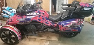

    Picture of my bike with the comfort seat which is not too comfortable for me.
