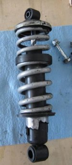

    Hi folks,
    Last Fall I noticed that my rear suspension was 'bottoming out' & decided to fix it.
    I bought a new shock absorber; not realizing that there are a fair number of parts that are in the rear suspension assembly.
    Here is a photo of the entire rear suspension assy:
    Note the upper & lower springs on the '08 model Spyders.
    Then David Hamilton ( Warlock on here ) PM'd me about his looking for a new upper, rear spring.
    So I waited a while to see what he might find.
    He found this Eibach spring & really liked the results.
    http://www.jegs.com/i/Eibach/369/0400.2250900/10002/-1
    So I ordered one. JEGS took rather a while to get it to me, but here it is:

    After struggling to get the suspension assy apart, we finally did it. Then it was rather straight-forward to do the re-assy.
    One part that gave us a lot of problems was the rubber grommet that goes into the bottom mounting boss of the shock absorber. That little bugger did not want to come out. And when it did, it went shooting across Darryl's shop. Since the shop is not real large, it was easy to find. But, again it was a bugger to re-install into the new shock absorber.
    Anyway, after all of the work out at Darryl's, I got the new suspension assy installed; here it is:
    It is still raining fairly hard here, so I have not had the opportunity to give it a try.
    I'll try to re-post on my thoughts after a 'few' miles on the new shock & spring.
    As David mentioned, we did have to do some grinding on the OD of the Eibach spring to get it to sit into the Can-Am parts just right. Not much grinding, maybe a few 0.001" or so.

    Hi folks,
    Re: I'll try to re-post on my thoughts after a 'few' miles on the new shock & spring.
    Well, I have just completed two 5-hr rides with this new spring:
    I have not bottomed out once with this new spring in place. And, you can definitely tell that it is a stiffer spring.
    I'm really glad that I made this change.
