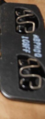

    If anyone has the front brake pad clips I would gladly pay to have them shipped to me in NC. Please let me know if you have some for sale.s-l1600.jpg

    Im looking for funny shaped ones that go on the front pads

    EBC now makes those clips and they come with their pads. I don't know if you can buy them seperate. When I broke one of mine I ended up making a new from piano wire. I went to a full line hobby shop after measuring the diameter and bought piano wire as close as I could get and make a template from a good one. It took a couple of tries but I finally made one that worked.
