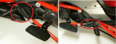

    I found some pics from someone here in the forum, and modified it to show what I'm talking about.
    The below two pics show the bracket I'm talking about that the rear footrest (peg or board) would attach to...
    ...I'm trying to see if this part can be swapped (or if there's some aftermarket solution) to make this a basically no longer have the bracket.
    For reference, here's the Daytona's rear foot area, and the bracket doesn't look like it has a place to install a peg / board for rear feet (as there's no rear seat). At least that's what it looks like to me...
    2015 F3 , Stock I use the Extended Brake Pedal Silver with black stripes and Can-Am Red/Orange accents

    Quote Originally Posted by EricP View Post
    Thanks for the pics; that helps me. It seems the footrest (peg) is attached to a removable bracket. Can you tell how that footrest bracket is attached to the frame?I'm betting the mounting points are there for the Daytona as well, but are just covered up with a piece of plastic. If so, we just need to figure out the part number for that cover.

    I have mine removed and I used black panel pops (plugs) to cover the holes. The main part that contains the threaded mounting holes has to remain. There is no sub'ing that piece out. You can sort of see what it looks like in these pics. You will have the "nub" sticking out but it stills looks tons better than having pegs there....
