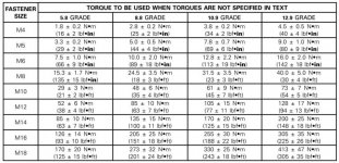

    Does any one know what the bolts are for the brake calipers front and rear that are to be replace each time removed. All I Get on the parts break down is front M10 X 65 rear M12 X 30. I am sure if I had the grade and size I could purchase then local.

    I reuse ours, just use some blue Loctite on them.
    Clean up the threads with a wire brush and your good to go.
    As M109Dreamer stated, make sure you use some blue loctite when putting them back in.

    I know I always did that on my Goldwing's and never had any problem. The torque is not that high so the threads should not be pulled any. Thanks for the advice.

    You have to get the grade off the old bolt but here is a chart on the torque
    Do you by chance have that pic in pdf? Would like to download it and keep it on my phone when Im out in the garage.
    just save it as a jpeg; then e-mail it or save with a USB connection to to your phone.
    That worked, thx

    I would go with grade 8 if you don't want to buy from a dealer.
