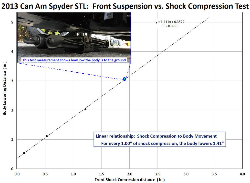

    I see you are getting a few comments, I'll add a few new ones. My first thought since you are riding 2 up is that your suspension springs are not up to the task. I have owned a 12 RTS and a 13 STL and have to add stiffer springs front and rear for both bikes. When the suspension springs are not up to the task, you easily bottom out - the impact of the shock bottoming out is the harshness you feel. Air pressure in the tires or setting the air pressure to set ride height doesn't help the weaker springs keep you from bottoming out the suspension.
    An easy thing to check is the bottom of your skid plate. Based on my testing on the STL, I found the bike lowers 1.4" for every 1" compression of the front shocks. If you are bottoming out [alot], you will likely see damage (scrapes) to the bottom of your front end. Post back what you see after looking at the bottom front of the Spyder.
    The stock STL front springs are 169 lbs/in straight rate springs (too weak IMHO), the fox shocks are 181 lbs/in and the ones I went with are 225 lbs/in.
    Jerry
