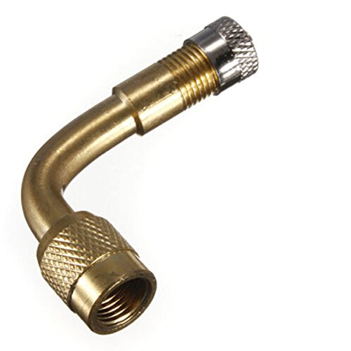

    Default Permanent mount valve extenders
    Has anyone tried anything like this? They also come in a 45-degree bend.
    2014 RTL Platinum
    Hmm....Looks interesting. Got a link?
    Dec 2015
    Oakley Utah
    8,126
    Quote Originally Posted by newbert View Post
    This is one on Amazon. They have a bunch of different types, styles, angles, etc.
    https://www.amazon.com/Fontic-Motorc...xtension&psc=1
    2014 RTL Platinum
    Apr 2017
    Queensbury, NY
    530
    Thanks for that link. But, after reading some of the reviews, I wonder whether it's a good idea to leave it on the valve stem. Some say that it destroyed the valve stem, and another says that it's puts the tire out of balance.
    Thanks for that link. But, after reading some of the reviews, I wonder whether it's a good idea to leave it on the valve stem. Some say that it destroyed the valve stem, and another says that it's puts the tire out of balance.Thoughts?
    Yeah, that's why I was asking if anyone had tried it.
    Thanks for that link. But, after reading some of the reviews, I wonder whether it's a good idea to leave it on the valve stem. Some say that it destroyed the valve stem, and another says that it's puts the tire out of balance. Thoughts?
    I'm inclined to agree with you. One of the products states clearly that it's for steel stems only, not the rubber ones. I'm going to check into Blue Knight's solution.
