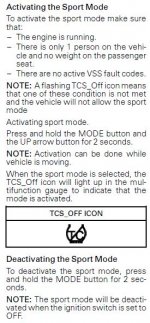

    Do ANY of them have a Traction Control Button?? Those I've seen didn't have one, & I was lead to believe that ALL those with the Sport/Hooligan mode feature used a Looong press on the Mode/Eco button to select Sport Mode...
    Sport mode indicator is item 11.
    Instructions to engage and disengage.

    I've only had my Daytona in it once to see if it would work. I'll try to snap an actual pix of it engaged and post it....
