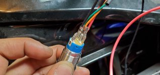

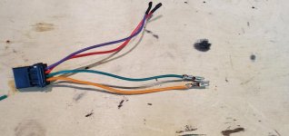

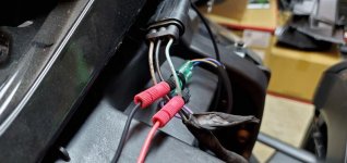

    So, since we are in lock down and I am "teleworking", thought now would be as good a time as any to revisit this. Using Rattlebars schematic and the Can Am wiring diagram, I managed to get it working perfectly (Fog lights off/switch light off - Fog lights on/switch light on)
    I ran two new leads directly from the positive/negative side of the switch to the right side fog light connector and rewired "C" and "NO" connections. When rewiring the switch, be sure to cut off the heat shrink first; makes pulling the connectors off much easier (don't forget to put some back onto the new connectors). When tapping into the fog light connector, if you choose not to cut/splice/solder, I HIGHLY suggest using Posi-Tap connectors instead of those cheap folding wire taps.
    I drew up a quick before and after diagram for those interested. Not sure if Lamonster still uses the same colors on his pig tails but the pics should help. The bike wiring colors are for a 2015 F3S but I suppose they should be the same for all others. Thanks all!!
