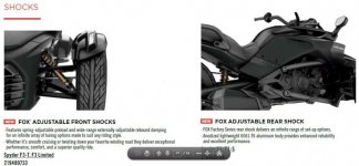

    These are the new shocks in the 2017 catalogue:
    Not cheap though, $700 for the rear one.
