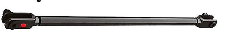

    There are 3 options, drilling the bracket the rod links to shown in this thread:
    http://www.spyderlovers.com/forums/s...ht=brake+drill
    or drilling the rod itself as in this thread:
    The ppic is no longer there but the idea is to drill a hole through the bracket at the end of rod where I've put the red dot here:
    That effectively shortens the length which will lower the pedal.
    Risks are that you will weaken the strength of the bracket and make it more prone to failure. AFAIK a few have done this but I've not seen any evidence of failures.
    3rd option is to cut the rod, chop a chunk out and re-weld it up. A few have done this with no issues AFAIK (depending on quality of welding of course).
    JC Thorne has done this on his and a few others I seem to remember.

    I went out just now and removed the brake rod. I drilled a 5/16 hole 1/2" behind the front hole on the forward end. I had to file 1/8" off the break lever to make the fit loose and not snug, it has the same play as before. This lowered the break pad 1" making it MUCH more accessible in emergency breaking. Tools needed...5/16 drill bit, 5mm allen key, 10mm socket, 16mm wrench (for break axel bolt) and a file. Another alternative would be to dremel out the safety notch located inside the break pad and drill out a hole installing a bolt 1/2" forward of the current bolt, this moves the floor board 1/2" forward though. The other way would be to cut the break rod, remove 1/2" and have it welded back together. Hope my pictures show the handiwork, its my first time loading pictures to this website so I'm hoping it goes smooth. I think overall I would have cut the pipe and had it welded back together if I was to do it over again.....just my thoughts.

    Thanks for sharing your handywork on the pedal, pictures really help see the difference. I think that's the first one I've seen where someone has drilled the pedal bracket. Looks to have done the job just as well.
    This does seem to become more of an issue wth the floorboards as they take your foot further from the pedal. Not so much of an issue if you're still using the pegs.
