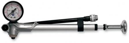

I usually use the portable air tank. Doesn't take much volume and no danger of over pressuring if you start with 50 to 60 psi in the tank. Worked well on the RT's and F3 air bags, and lowered the tank pressure for the 15-20 psi in the Harley air shock. Also works well to balance the front tire air pressures by starting at 20-22 psi in the air tank and go back and forth a couple of times to balance the tire pressure within 0.5 psi as advised by BRP.
