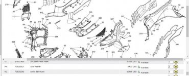

Diagrams with Oval washers for spyder

Going to any of those on-line parts stores / dealers, like cheap cycle parts, Pitbull, etc., go to your model and year and bring up the Body and Accessories diagram - the first of the Body and Accessories series. The grommets underneath the fake torx screws appear to be item number 148 - called oval washer. I think that's Canadian for grommet. The other ones you're looking for might be on that same diagram. At 3 to 4 bucks each, plus shipping, might be more efficient with your time and gas to just order them on line and get the right ones the first time.
Thanks Snowbelt. I've done that on every one of those diagrams I can find, but they don't show numbers for a lot of the places these types of rubber grommets are used. Don't know why. I did find the "oval" one...Part number 705000321, but not the round hole one. Also, as I said in my post, I can't determine where each is used on our parts (round vs oval) but I know both are used.
FYI, I did find 1 picture I took when I had the side panels off that shows one of the holes for the grommet being elongated. Can't make out the other hole to see if it is the same or just round. Having no grommet in the hole "may" be the only way you can tell what they want......which is after you already really need a replacement in hand :-))
If I missed something in one of the diagrams please let me know.
Correction........I just looked again at a diagram of Can-Am source parts and "maybe" I was looking for something that doesn't exist. Maybe all 4 on the side panel ARE Oval. The other round ones I have seen are from removing the curved body section by the front wheel...and actually all of those are different overall construction. THANKS for making me look again !!

The parts are called Oval Washer, PN 705000321, and they come in pairs @ $4.33/pr from BRP. Check Cheap Cycle Parts for a lower price. They are in fact different from the round grommets that hold the side panels in place.
Do yourself a favor when reassembling panels, courtesy of SpyderAnn01, lightly spray the grommets with a spritz of windex and the pins will almost jump into place, no undue pushing necessary.
JayBros,
All I see is places selling (qty 1) at $4.33 each. That's OK with me but where do you see packs of 2 for $4.33?
Agrre on quantity per side and price is per grommet.
