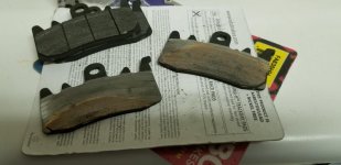

Got them installed, work like a dream. I have had a noise from my right wheel ever since I bought it and that sound is now gone. Thanks again.
These are the ones I pulled off.
Maybe a little thin?
[QUOTE=AlphaJoe;1337088]Got them installed, work like a dream. I have had a noise from my right wheel ever since I bought it and that sound is now gone. Thanks again.
[/QUOTE
Can I ask. About how many miles did you get on that (I assume) first set of brakes?
[QUOTE=fulltimer;1337311]Just over 10k.
I think there is a problem with that wheel. If you look at the pic, the two that were worn down to the metal was the right tire. The ones in the top left of the pic were the left tire. The top left ones were only halfway through, there was a good 8th of an inch or so left. Either the left brake isn't gripping, or the right one is gripping too much. I am going to keep an eye on them. Like I said, there was a constant noise coming from that wheel, even if I wasn't hitting the brakes, so I think it might have been stuck and rubbing. I have noticed that the bike rolls for a longer period now as well.
I bought from bajaron too and it have 2500km on it, brakes well.
But have squealing sound from time to time till today...
Is there anyway i can get rid of the squealing sound?
Since you said you had a noise on the right and the right appear to be down to the metal,did you check the rotors for scoring or warpage?
Didn't you have a sever "pull" to the right when braking?
