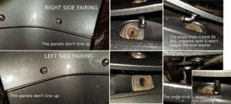

5 Attachment(s)
More problems, damaged Angle Knob
I finally checked the loose right Lower Grill yesterday. I did remove the Side Inspection Panel and pulled the grill out. I watched a https://youtu.be/rOO7p5i1cJE video and it looks like while Pierre wiggled the grill to get it out, it snapped out of the bottom (@ 9:20 minutes). Mine didn’t snap out.
The Left Lower Grill does have two pins and is not a solid piece with the bottom.
Could someone please push on their right Bottom Grill to feel if it is solid or if it moves (in the area where my finger is on the first picture) and let me know?
There is no access from the bottom and I can’t find any video of how to put it back correctly. Pulling the inside apart gently, I don’t see any holes to push the two clips in, no holes.
I also found that the Oval Washer on this right Lower FairingSide Panel is pushed halfway in while the panel wobbles on that side. Inspecting it deeper by pulling off this panel gently, the Angle Knob is bent 90 degrees and snapped at the bent, therefore damaged. It does not lock/snap into the Oval Washer at all, therefore the wobble.
I did remove the left lover grill Side Inspection Panel as well and discovered that the left Push Pin of the Lower FairingSide Panel is not locked in the left top fairing’s panel and I can’t be even pushed in. The Angle Knob does not line up with the Oval Washer making the panel wobble – I don’t want to brake anything.
I was wondering why aren’t the panels lining up together as they were originally.
I am planning on plasti-dipping some areas of the bike and taped the sides for the pattern in winter and therefore I can confirm with pictures the panels were nicely matching before the 3000 mile service. I am a perfectionist and catch little differences.
I am pretty upset at this point and realize I should call the dealer to have it fixed. Or should I go to another dealer? Or should I try to fix it by myself – which means learning on how to snap off the mirrors and take everything apart? I realize another Saturday ride with our Goldwing group is gone for me, as was the last one due to the bike being done just a day later than promissed.
With that mentioned, I will order one the BRP Manual CD, push pinpliers, push pins (or these push pins), extra Oval Washers, Angle Knobs, and Mirror Housing Clips. I found nice drawings with part numbers without having the Manual.
Will I have to replace the Metal Pins on the other side of the Angle Knob? I am lost at what its called and what’s the part number.
