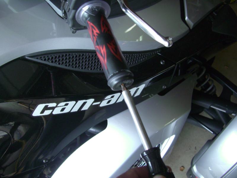

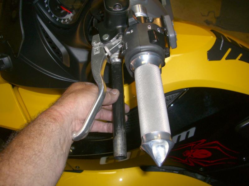

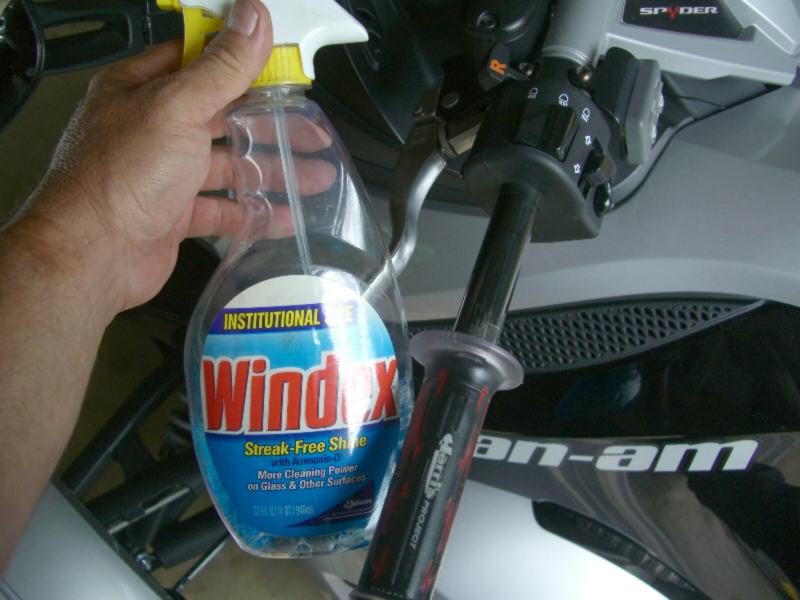

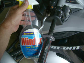

First thing you are going to do is remove the plugs in the ends of your stock bars and remove your grips. I use a screwdriver and a little Windex to get the grip off. Just work the screwdriver around while you're squirting the inside of the grip.

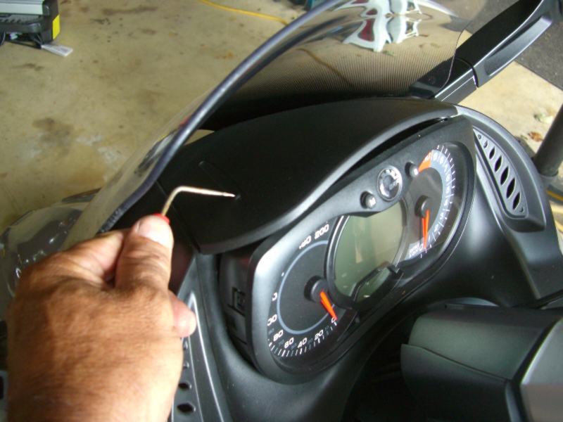

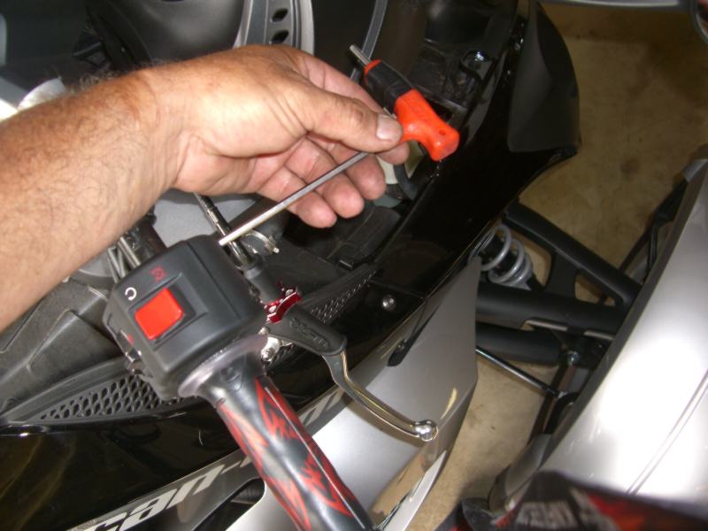

First thing I did was pull my gauges. You just pop the top out with a screwdriver.
http://www.spyderlovers.com/risers/CIMG5426_small.JPG

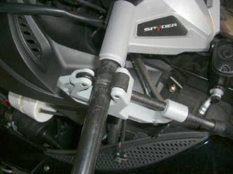

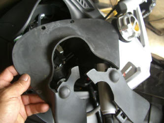

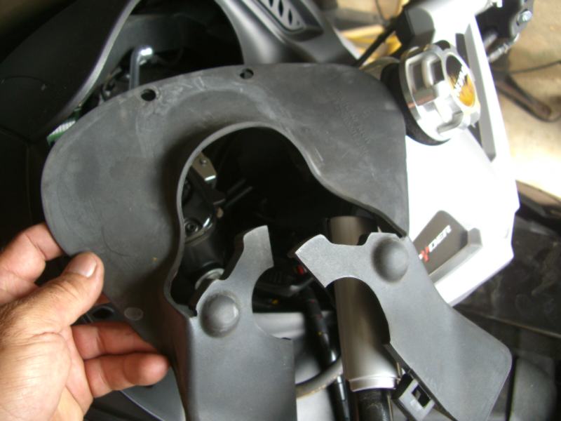

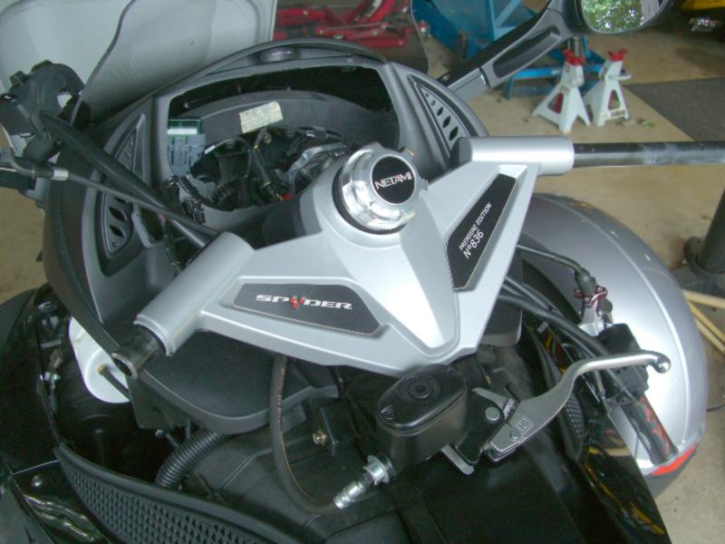

Next thing I did was pull the the top Y cover and the rubber boot that hides the cables.
http://www.spyderlovers.com/risers/CIMG5430_small.JPG

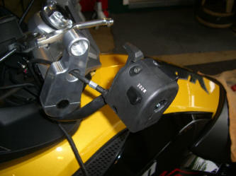

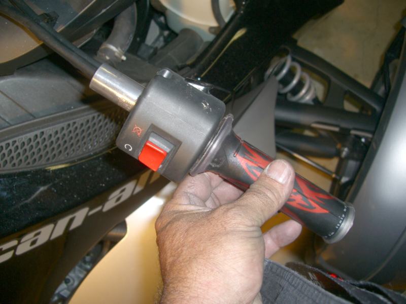

Now you can pull the controls off of the bars and check to see how much slack you have.
http://www.spyderlovers.com/risers/CIMG5431_small.JPGhttp://www.spyderlovers.com/risers/CIMG5432_small.JPG

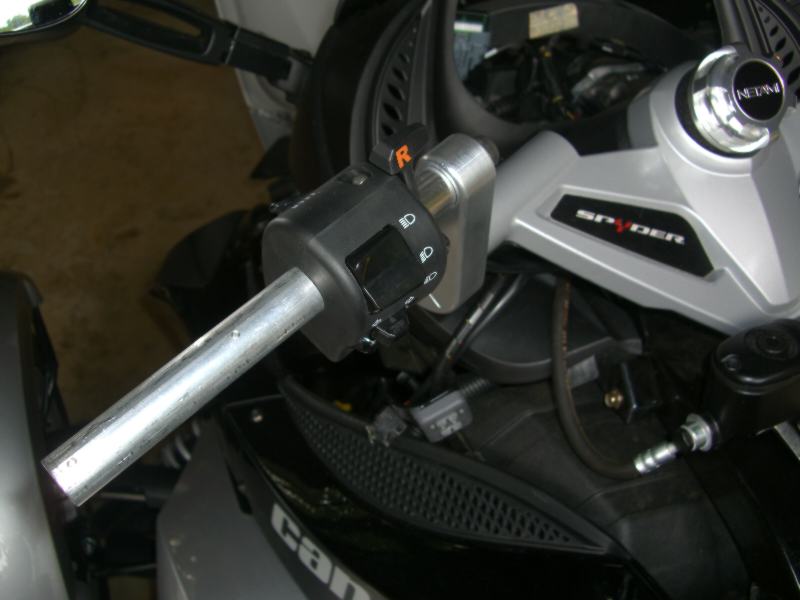

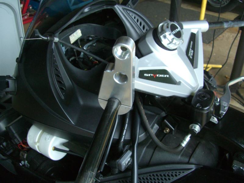

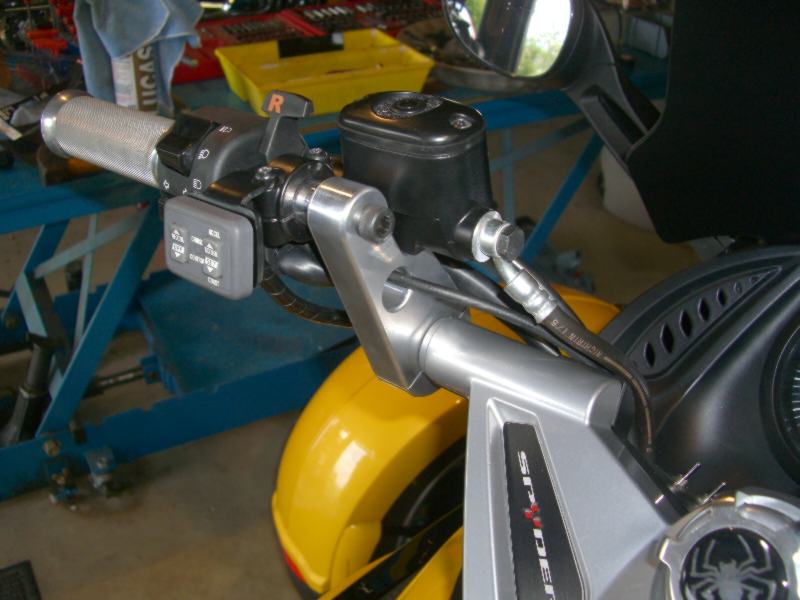

The left side riser will have a notch in it for the reservoir. Go ahead and slide it on the stock bar.
http://www.spyderlovers.com/risers/CIMG5434_small.JPG

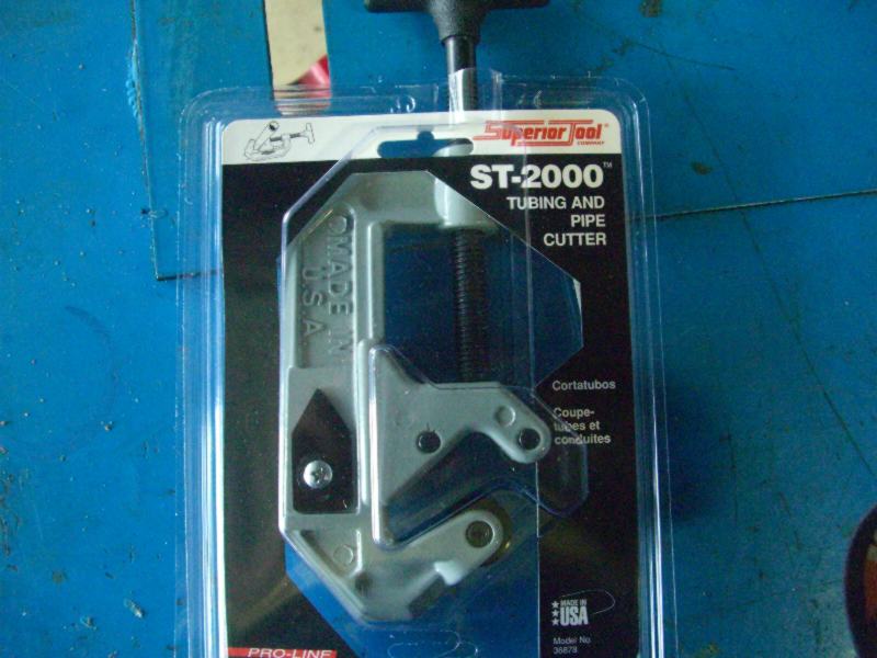

At this point you can mark your bar and cut the end off. You can use a hacksaw, sawsall or whatever you like for this. I bought a little pipe cutter and it worked great. Just clean up the end with a file or grinder.
http://www.spyderlovers.com/risers/CIMG5423_small.JPGhttp://www.spyderlovers.com/risers/CIMG5439_small.JPG
http://www.spyderlovers.com/risers/CIMG5440_small.JPG

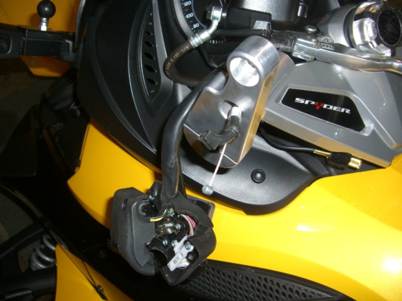

On the left side you're going to want to run the reverse cable through the hole in the riser.
http://www.spyderlovers.com/risers/CIMG5436_small.JPGhttp://www.spyderlovers.com/risers/CIMG5437_small.JPG
You will get a new bar that bolts into the riser, This bar has a slot in it to locate your control housing.
http://www.spyderlovers.com/risers/CIMG5435_small.JPG

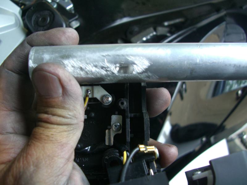

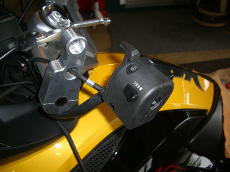

You can install the control housing to the bar making sure the pin on the housing is located in the slot on the new bar.
http://www.spyderlovers.com/risers/CIMG5441_small.JPG

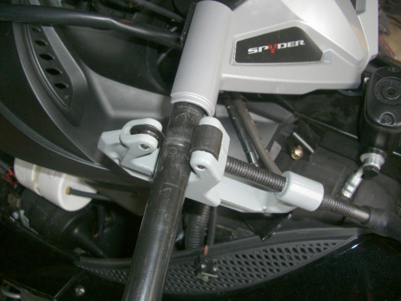

Install the bar to the riser with the bolt provided. Leave the bolt loose so you can adjust as needed.
http://www.spyderlovers.com/risers/CIMG5442_small.JPG

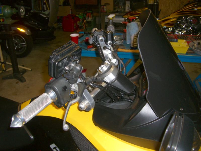

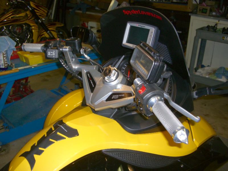

Here's where we switch Spyders. Install the clutch reservoir and rotate the riser where you need it and check cables for slack and reroute if need be. Once you're happy with that tighten all the screws and bolts and move on to the throttle side.
http://www.spyderlovers.com/risers/CIMG5443_small.JPG

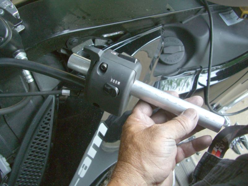

Same process on the throttle side. Just make sure all your cables are free when in a full lock. They may be a little tight but as long as you're not stressing them too much you should be fine. The only time you'll be at a full lock in in a parking lot anyway.
http://www.spyderlovers.com/risers/CIMG5448_small.JPG

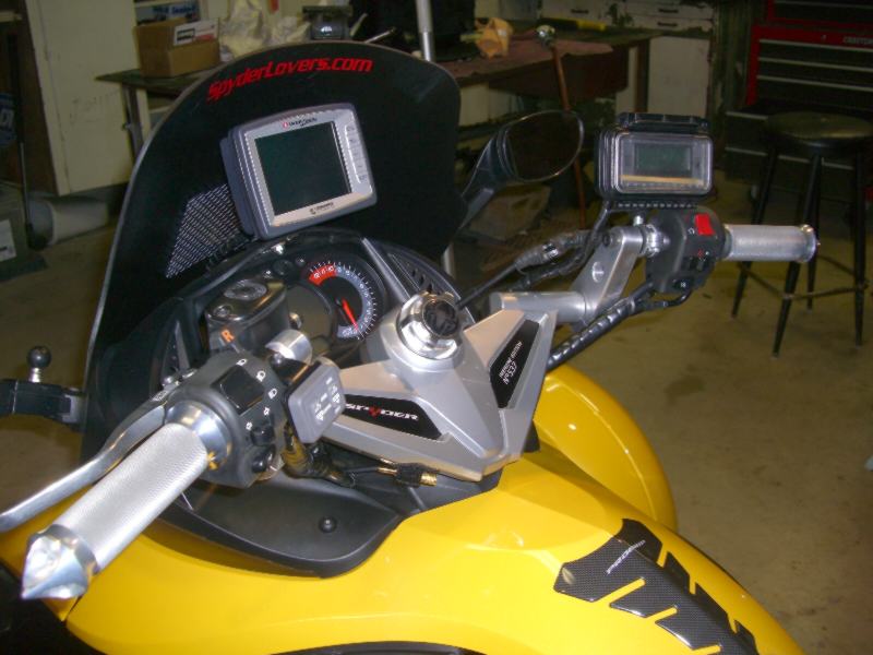

I found that the vibration on the bars is just about gone now that I have these risers and I could never see going back to stock. if you did want to go back to stock you can replace the stock bars for about $60 bucks.

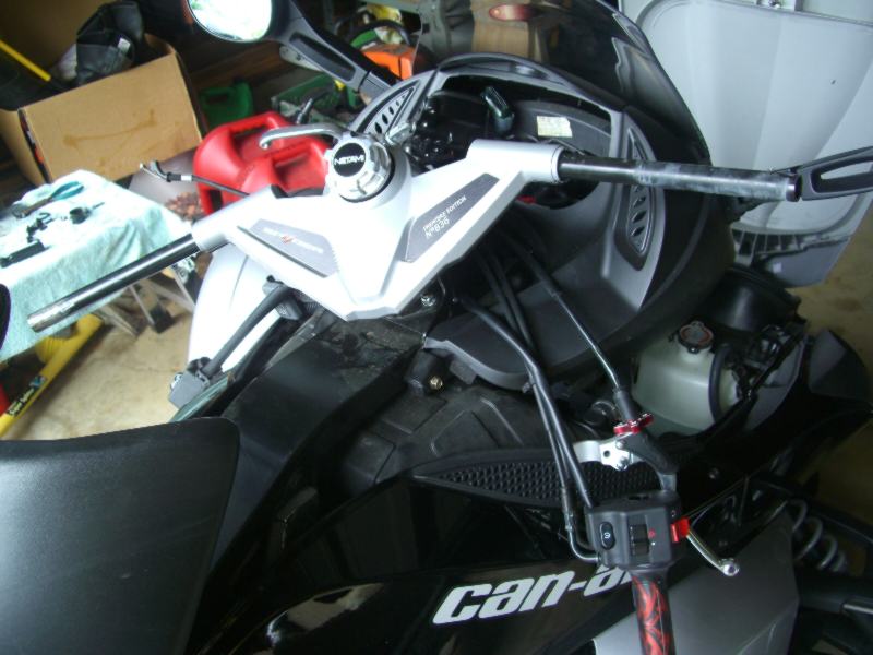

Here's what they look like on my Spyder. You can order yours from www.NoMagicNeon.com
http://www.spyderlovers.com/risers/CIMG5444_small.JPGhttp://www.spyderlovers.com/risers/CIMG5445_small.JPG
http://www.spyderlovers.com/risers/CIMG5446_small.JPGhttp://www.spyderlovers.com/risers/CIMG5447_small.JPG
