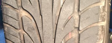

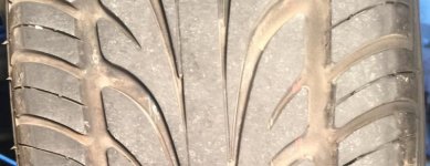

Right front tire wearing on inside
I just noticed today that my right front tire is wearing badly on the inside. I check my air pressure on a regular basis and never noticed before.
Maybe because of the way I was parked outside and in the sun it just happened to catch my eye, who knows.
The tires have 6,000 miles on them. The left side tire looks almost like new as does the ourside of the right tire.
I had the dealer install the baja ron sway bar 1200 miles ago. Could this be the cause at all???
Obviously it looks like an alignment issue but I was wondering about the sway bar replacement so though I'd ask.
thanks
Greg
Looks like the inside wear on the right tire on our 11 RT
When we bought our first Spyder in 2012, it was assembled from the crate and with several thousand miles use, had a severe inside of the tire wear develope. We got the Spyder aligned by Lamonster garage in Springfield the next Spyderfest trip, and we did remount the tires on the wheels and got some more useful wear out of them although I did not record the mileage at the time. If your tires are otherwise rolling smooth with no vibrations or other wise uneven wear, Your Choice on how to proceed. Car tires will give you better wear and most likely better/smoother roll, as has been our experience with some Michelin defenders mounted on the 14 " wheels on the 11 RT model. The Michelins were still on the bike when we traded it with 76,000 miles on the odometer. The front tires you can usually count on getting about 20,000 miles if you watch them and at about $100 a tire depending on your choice, It's your call, and hope there are not any other frame or A-arm issues contributing to your wear. How many total miles on the bike?
